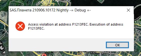

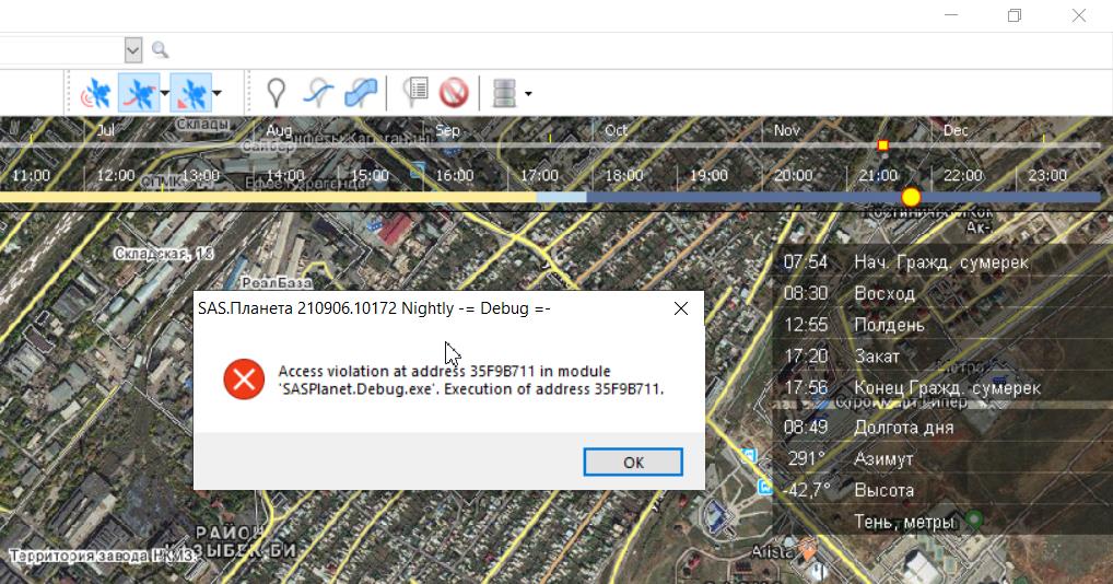

| Description | This error (see attached image) appears on both Nightly version and on the last stable version. There is no particular action which could be a reason. I use Maxar and Bing maps (switching between both) for mapping the points. Later on I export the placemarks as kml. Already present points layer and a grid layer are opened as kml-files. During the workflow, at some point, appears this error. Then I can only shut down the program through the task manager. Could you help me on this to solve this problem? Thanks! | ||||||||||||

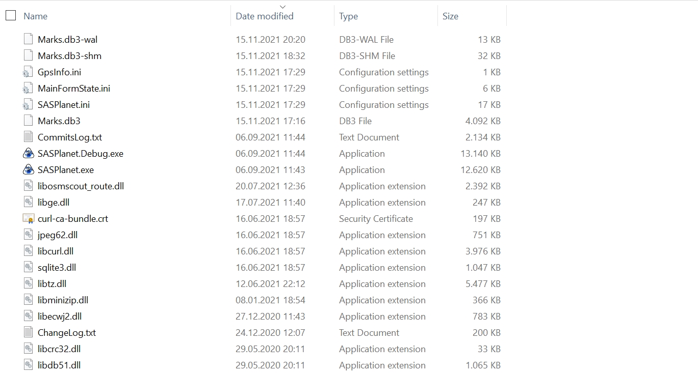

(0020203) do (reporter) 15-11-2021 19:41 |
Unfortunately I get no .elt file (or any additional file) generated when I get this message in debug modus. See the screenshot of the files sorted by date. When this error appears, the only way to get out is to close the software through the task manager in windows, but there are no changes in my root folder. Klicking hundreds of times on OK doesn't help either. Could it be a problem for not generating the needed file? In the time i was trying to get the needed file through Debug.exe, i had some observations. I have always two .kmz files imported, one point layer i am working on, and one grid layer in polygons. In the meantime I had the kmz-layer with poligons deactivated, I did not get this error. Tomorrow I will try out without this layer, to be sure if it was a co-incidence or not. The thing is, that the error appears only on my laptop, and there is no problem at all on my normal desktop computer. |

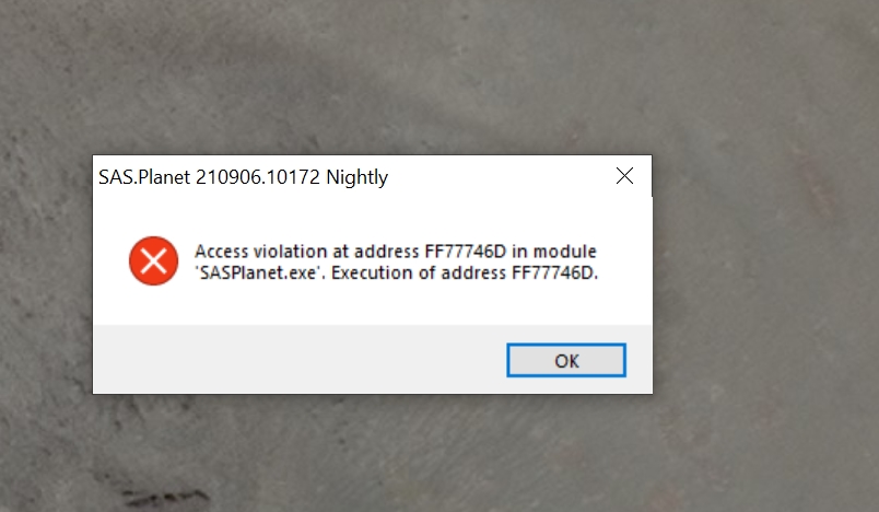

(0020205) do (reporter) 15-11-2021 22:42 |
The error window looks like the same, just the number of the error is different - see attached image. With the click on OK the number of the address of the error was changing, but after 3-4 clicks it was the same error address. However i can accelerate the error with the above mentioned grid-kmz indeed which makes it seems the trouble (on my laptop). As soon as I activate this layer or add it, I become this error, just by zooming out and in the maxar map. So long I tried to work on without this kmz-layer (polygon grid), i had no error. |

Ловлю данную ошибку уже много времени. Надеялся с каждым обновлением, что уйдет. А оно не ушло. Пришел на багтрекер и увидел, что совсем недавно завели данный баг. Запустил SASPlanet.Debug.exe, поймал ошибку - elf не появился. Ошибка перекочевала с прошлого ноута на новый и продолжается с каждым обновлением. Сейчас стоит версия 210906.10172 |

Да, падает при отрисовке полигона. Можно ничего не делать, кроме как крутить колесо, меняя масштаб и гуляя по карте и поймать ошибку. С калькулятором солнца дела не имел. Без подсказки даже и не найду где это включается. |

с включенным калькулятором солнца также поймал ошибку. скрин приложу. elf так и нет |

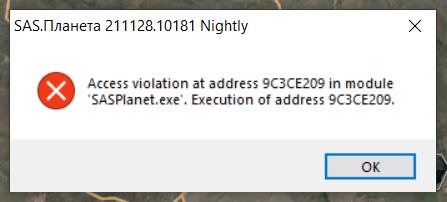

(0020227) bond (reporter) 30-11-2021 06:42 |
В новой ночной сборке 10181 такой же баг. |

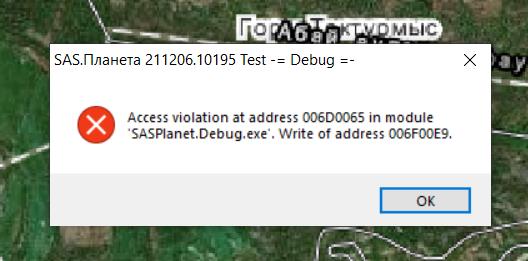

(0020240) bond (reporter) 07-12-2021 12:03 |
файлы приложил. В момент ошибки лог файл был пустым, заполнился только после того как убил процесс. Ошибка ловилась долго. На сколько понял, в данной версии карта загружалась заново с сервера, т.к. в кэше данные участки явно были. |

могу путаться в правильном определении полигона. Я просто изменял масштаб скролом. От 13го до 21го. В один из моментов при изменении масштаба вышло окно с ошибкой. Полдня ловил. При изменении масштаба было заметно, как SAS грузит карту с интернета квадратами. При том, что данная область у меня однозначно была в кеше - неоднократно гулял по этой местности. Мне тоже не совсем понятно, почему так долго. Раньше не то чтобы "тут же", но могло появиться и через 5 минут использования и через 30. |
