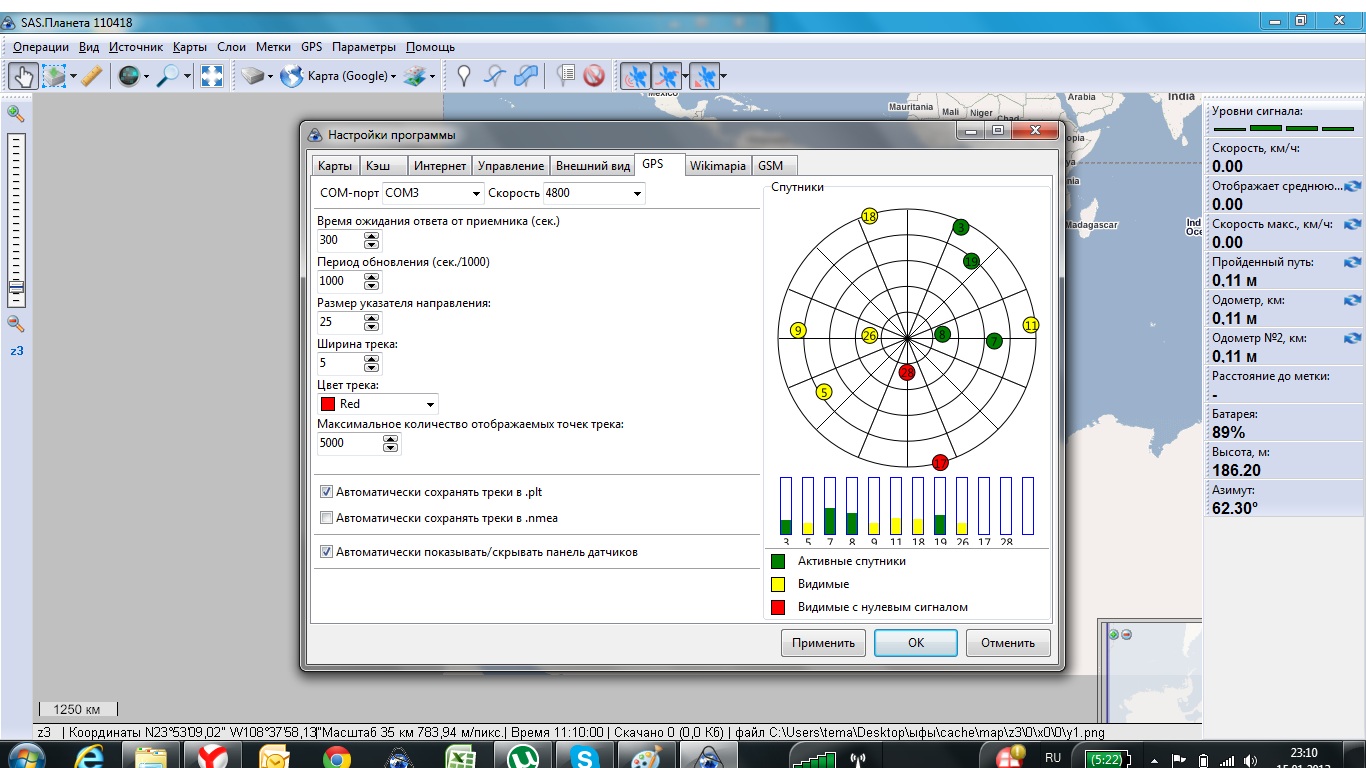

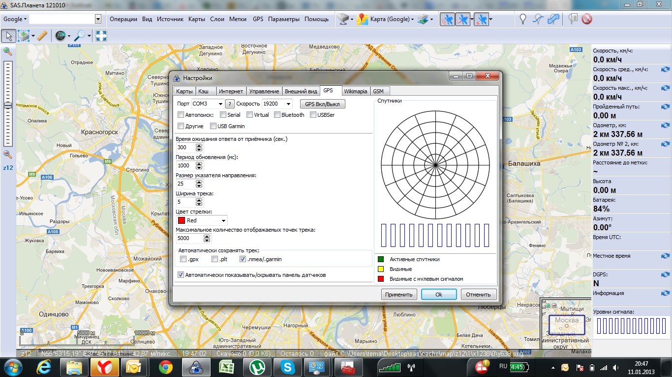

| Description | не могу подключить, не видит спутников ноутбук lenovo thinkpad x230 на штатном gps при этом программа, отлично работает на v.110418 | ||||||||

с включенным gps gate но тоже не работает с digma m1 работает( Looking for NMEA data output from a GPS ..... No NMEA data found on Com Port : COM4 at 4800 Baud No NMEA data found on Com Port : COM4 at 9600 Baud No NMEA data found on Com Port : COM4 at 19200 Baud No NMEA data found on Com Port : COM4 at 38400 Baud No NMEA data found on Com Port : COM4 at 57600 Baud No NMEA data found on Com Port : COM4 at 115200 Baud No NMEA data found on Com Port : COM5 at 4800 Baud No NMEA data found on Com Port : COM5 at 9600 Baud No NMEA data found on Com Port : COM5 at 19200 Baud No NMEA data found on Com Port : COM5 at 38400 Baud No NMEA data found on Com Port : COM5 at 57600 Baud No NMEA data found on Com Port : COM5 at 115200 Baud No NMEA data found on Com Port : COM6 at 4800 Baud No NMEA data found on Com Port : COM6 at 9600 Baud No NMEA data found on Com Port : COM6 at 19200 Baud No NMEA data found on Com Port : COM6 at 38400 Baud No NMEA data found on Com Port : COM6 at 57600 Baud No NMEA data found on Com Port : COM6 at 115200 Baud |
